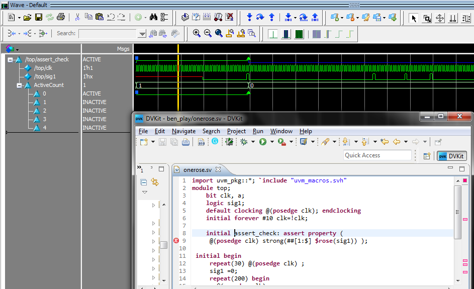

In reply to sanjay864u:
I am not sure I totally understand your question, but if you just want one occurrence of the assertion use the initial statement.
import uvm_pkg::*; `include "uvm_macros.svh"
module top;
	bit clk, a;
	logic sig1;
	default clocking @(posedge clk); endclocking
	initial forever #10 clk=!clk;
	initial assert_check: assert property (
     @(posedge clk) strong(##[1:$] $rose(sig1)) );
 initial begin
 	 repeat(30) @(posedge clk) ;
 	 sig1 =0;
     repeat(200) begin
       @(posedge clk);
       #2 if (!randomize(a, sig1)  with
           { a dist {1'b1:=1, 1'b0:=3};
             sig1 dist {1'b1:=1, 1'b0:=20};
           }) `uvm_error("MYERR", "This is a randomize error")
       $finish;
endmodule
simulation resuts:
Ben Cohen
