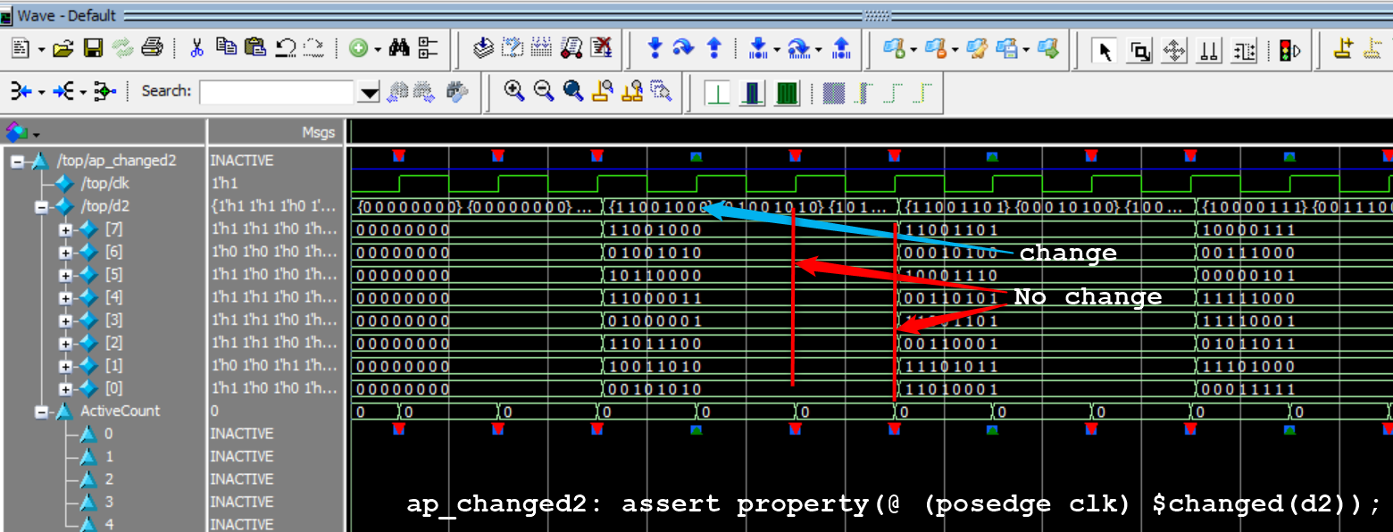

import uvm_pkg::*; `include "uvm_macros.svh"
module top;
bit clk;
bit d2 [7:0][7:0];
initial forever #10 clk=!clk;
ap_changed2: assert property(@ (posedge clk) $changed(d2));
initial begin : ini1
repeat(10) begin :rpt1
repeat(3) @(posedge clk) #1;
if (!randomize (d2) ) `uvm_error("MYERR", "This is a randomize error");
end : rpt1
$stop;
end : ini1
endmodule
Ben Cohen
http://www.systemverilog.us/ ben@systemverilog.us
For training, consulting, services: contact http://cvcblr.com/home.html
** SVA Handbook 4th Edition, 2016 ISBN 978-1518681448
In reply to ben@SystemVerilog.us:
Ben,
A hierarchical_identifier could be a variable of any type. The BNF does not deal with type compatibilities, only syntax. You need to look at the text of the LRM to see the semantic rules and restrictions.
