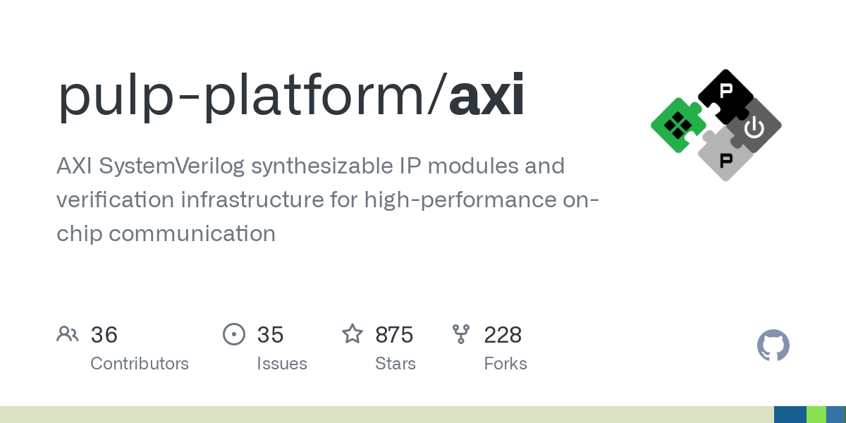

I was trying to simulate the following axi project:
In reply to Zafar:
You want to use the provided scripts to compile and run.
