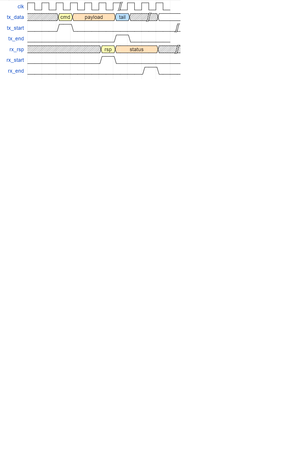

the protocol that dut uses is a bi-directional, req/response protocol, similar like pcie tlp (memory read/write, and write also needs response) but far simpler since it is an on chip bus and no switch connection)
the figure below is tx cmd examples. anyway, dut/agent could receive commands at any time as long as rx bus is idle, and relies status after cmd finished.
