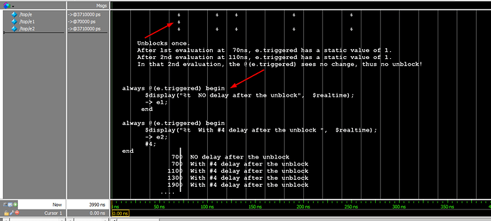

Many thanks for your explanation and support. I would like to share with this community your other example and add a few more words.
- The syntax (only relevant parts shown here)
event_control ::=
@ hierarchical_event_identifier
| @ ( event_expression )
event_expression ::=
[ edge_identifier ] expression [ iff expression ] // int i; event e;
// e.g., (posedge clk), (I), (e.triggered)
// (e)
- Reevaluation: The entire event control expression essentially has static value, and there needs to be an event on one of the visible operands in the expression for it to get reevaluated.
- Blocking: If the event_expression is true, it unblocks.
- the e.triggered: The triggered() method returns 0 when called in a time slot before the trigger (-> or ->>). It is static for the process that made the call.
If the(e.triggered) changes in value it unblocks. For example:
always @(e.triggered) begin // CALL THIS Z (for zero)
$display("%t NO delay after the unblock", $realtime);
-> e1;
always @(e.triggered) begin // CALL THIS D (for delay)
$display("%t With #4 delay after the unblock ", $realtime);
-> e2;
#4;
The Z always-block, without the #4 delay, unblocks once. This is because
- 5. After 1st evaluation at 70ns, e.triggered has a static value of 1 (was 0).
6. At the end of the Z always-block (at 70ns since the block has no delay statement), the e.triggered gets reevaluated because it goes back to the always statement and returns a 1 (no change in the same time step). Thus, that Z always-block gets blocked
7. After 2nd evaluation at 110ns, e.triggered returns a 1 because at 110ns, there was an event e. In that 2nd evaluation, the @(e.triggered) sees no change (was a 1 at 70ns, is a 1 at 110ns), thus no unblock!
The D always-block, with the #4 delay, unblocks at every event. This is because
- After 1st evaluation at 70ns, e.triggered has a static value of 1 (was 0).
- At the end of the D always-block (at 74ns since the block has a 4ns delay statement), the e.triggered gets reevaluated because it goes back to the always statement and returns a 0 (no event in that time step).
- After 2nd evaluation at 110ns, e.triggered returns a 1 because at 110ns, there was an event e. In that 2nd evaluation, the @(e.triggered) sees a change (was a 0 at 74ns, is a 1 at 110ns), thus it unblocks!

In reply to dave_59:
Dave, there is just one more point which I want to make sure of. When I simulated your example, my initial guess was that the term “@(event_name.triggered)” would be printed twice, first at #10 and then at #20. But I saw in the results that it was only printed once at #10. I guess the reason for this is that, as Ben explained, “…the change of the return value of the triggered method from 1’b1 to 1’b0 at the end of the current time step will not affect an event control or wait statement waiting on the triggered method.”.
So, in short, the event control construct does not see the return of the triggered from 1 to 0 at the end of time step at #10, therefore, it’s re-becoming 1 again at #20 will be invisible too. The event control construct never saw the method become 0, so when at 20 it sees the value of 1, it won’t detect any change.
Is my understanding correct?
In reply to Farhad:
Correct.
Just remember if you ever find the triggered method in an event control, you have probably found a bug.
