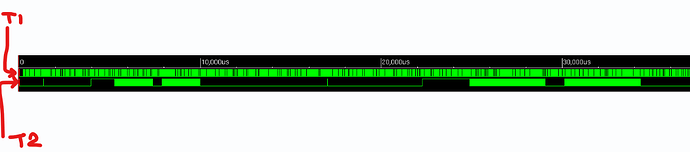

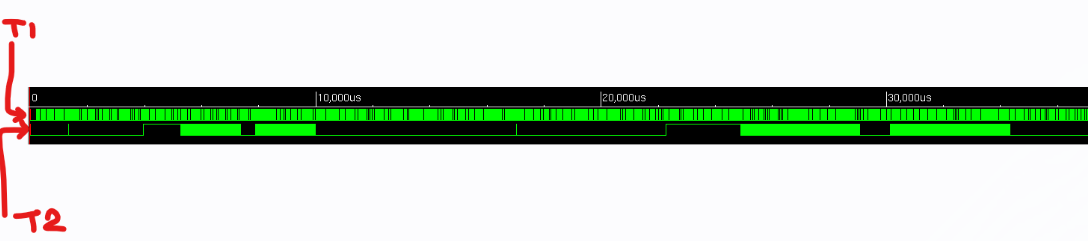

Using fork join [all] I can see that the second thread is not being called correctly. So I decided to go with fork join_none (which gives the behaviours of 2 independent always blocks).
As you can see below:
Thread 2 is hardly being called using fork join [all]

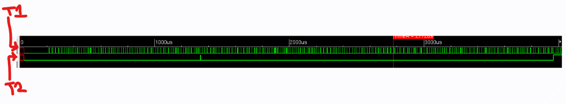

Instead, I would like something like below:
