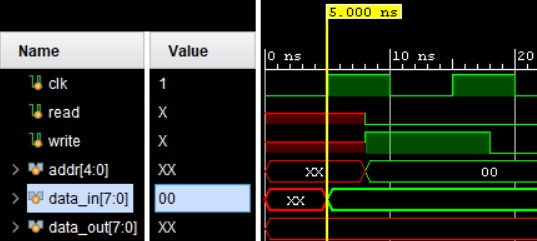

Clocking Block default output skew not applied to output signal in Vivado Simulator 2018.x
clocking cb @(posedge clk);
default output #2ns;
output #3ns read;
output #3ns write;
output #3ns addr;
output data_in;
input  data_out;
endclocking
Expected behavior:
  • data_in should inherit the default output skew of #2ns.
Observed behavior in Vivado Simulator 2018.x:
  • data_in is driven at the clock edge with no delay.
  • If I explicitly write:
output #2ns data_in;
then the delay is applied correctly.

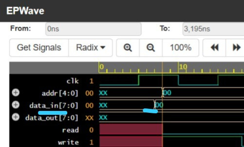

Comparison:
  • The same code works as expected on EDA Playground using Synopsys VCS, where data_in inherits the default skew.
Question:
  • Is this a known limitation/bug in Vivado Simulator 2018.x, or is there any restriction on the use of default output skew inside clocking blocks?
