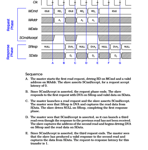

Hello guys, I have a task of verifying OCP protocol. it has 3 phases Request, Response, and Handshake. What is the best way to implement it? The pipelining is from slave side not the master.

If you do not show how the timing is between the 3 phases it is impossible to give an advice.

Response and Request Phase
Data Handshake Phase
explanation of data handshake phase
My idea was to make a connection between monitor and sequence. monitor will capture using uvm_blocking_peek_imp#, the requests and put them in queue, and after that I’ll drive SResp after some random delay.
Handshake and Response phases can be enabled disabled through parameters.
