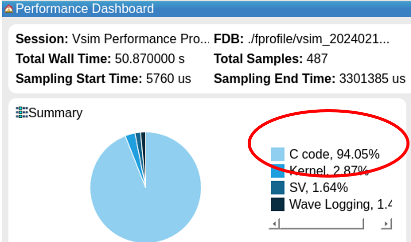

  4. PERFORMANCE. I did a small test on the tinyalu example and applied 120 000 transactions on both a UVM testbench and the cocotb tb and even on this small example, Cocotb was 2x Slower.
The main reason for this is that for every clock cycle, communication is done between python and questasim through FLI/PLI which means that a lot of time is spent on this:
It also means that the performance will probably be exponentially slower the bigger your design and testbenches are.
