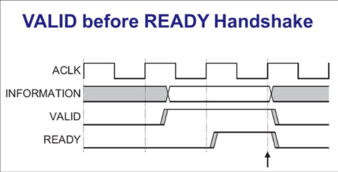

I am trying to write Driver for the following scenario where Valid and Information could be driven between two posedges of clock

  wait( $rose(vif.VALID & vif.READY,@(posedge vif.ACLK) );
  // Unblocks when handshake occurs

(Q1) Once get unblocks, are there any advantages of waiting for the nearest posedge of clock ?
(Q2) If Ready were asserted before Valid is driven then would we ever observe Valid being asserted or would it be overridden with 2nd NBA ( with value as 0 thereby never seeing it’s assertion ) ?
