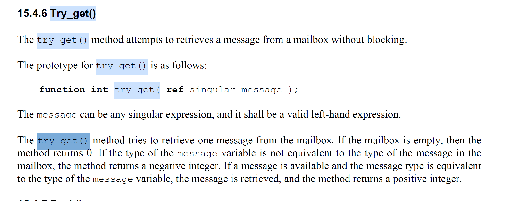

Hi @dave_59 , can we implement typeless mailbox and add synchronisation between them using try_get() method in receiver side ? I guess if mailbox is declared type less we can pass any type of arguments ?
From LRM - try_get() will return negative numbers is type is mismatched. so later we can add out of order kind of logic receiving logic to detect type of the packet.
I would avoid using typeless mailboxes. A typed mailbox will throw a compiler error if not constructed correctly. On the other hand, a typeless mailbox might let you to wait until runtime to issue an error, and even then, you might not ever see an error, potentially leading to a deadlock or a livelock.
