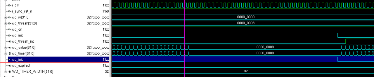

- when ever, signal wd_init = 1 @(psedge clk)then on next cycle signal " wd_value " should get loaded with wd_iv data(in this case its 0000_0009 )
i am trying to write a checker,how can i intercept only this condition from those gient waves, i tried as following.
